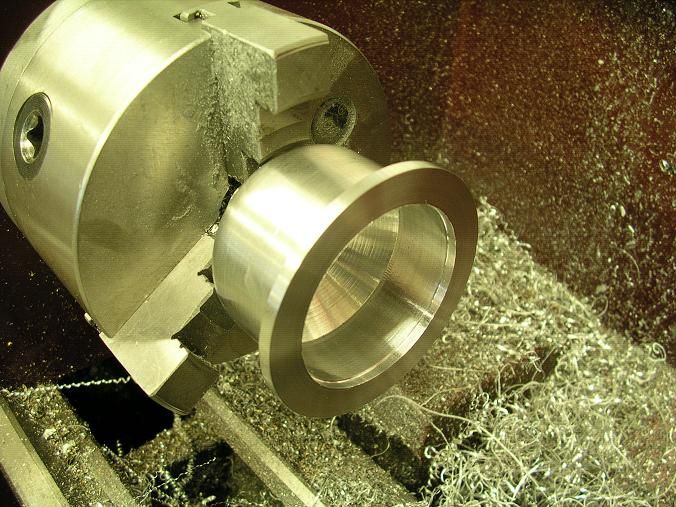

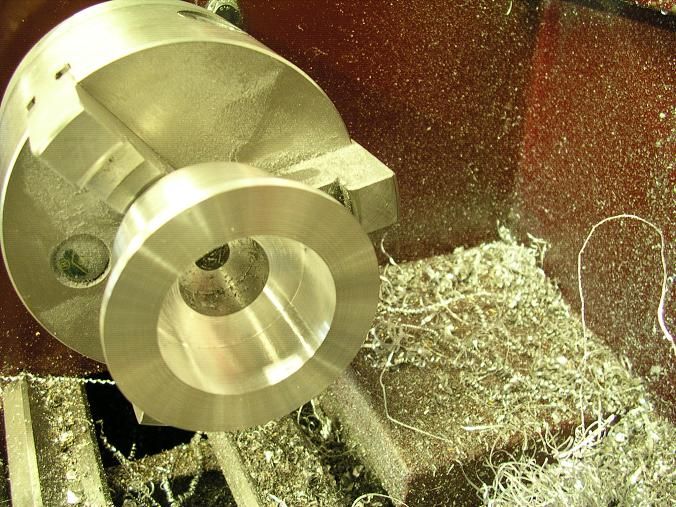

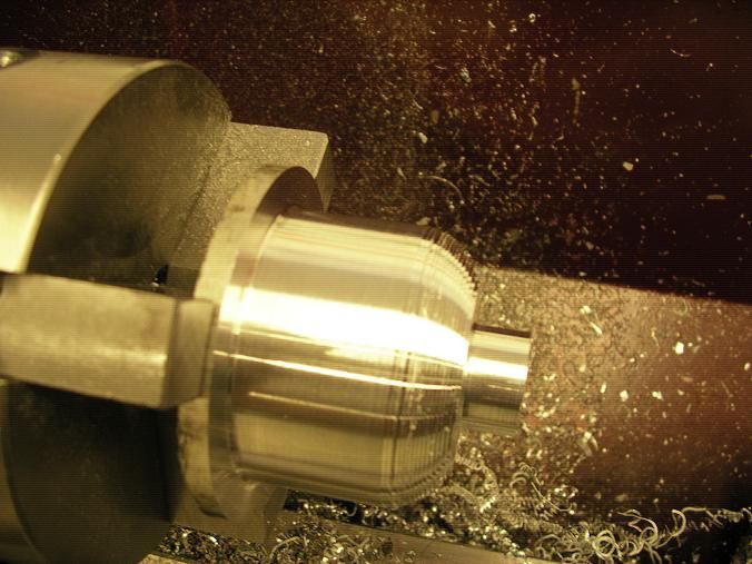

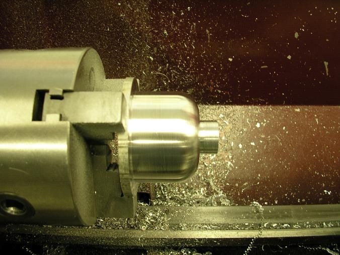

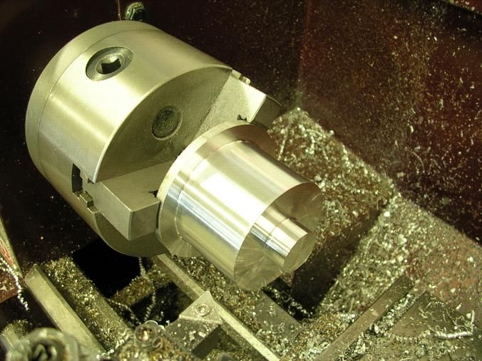

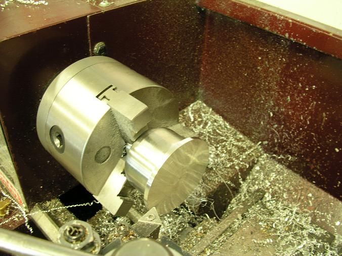

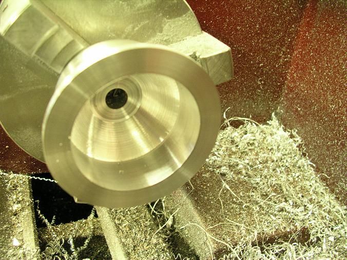

« Reply #12 on: August 13, 2010, 20:27:10 pm »
Hello all!
Managed some garage time today. Worked on the bell housing.
Started by machining the OD of the housing and establishing the back of the flange. Then I machined a small boss on the rear so there would be something to hold onto the part when it gets rotated.
I learned this one from watching the members on the HMEM site. I machined steps every .025 to the proper depth to form a .500 radius.
Then with a file and some sand paper, the steps were blended together to form the curve.
The part was then rotated and the flange was brought to size.
The inside was drilled thru and the two bores were made.
The insite corner was knocked down on a 45 degree angle to complete the inside shape.
A small step was them made to give the proper size to fit the boss on the rear plate.
Again the part was rotated and the holding boss was removed and cleaned up a little.
I still need to drill the hole pattern to mount the piece but that should be a quick deal!
