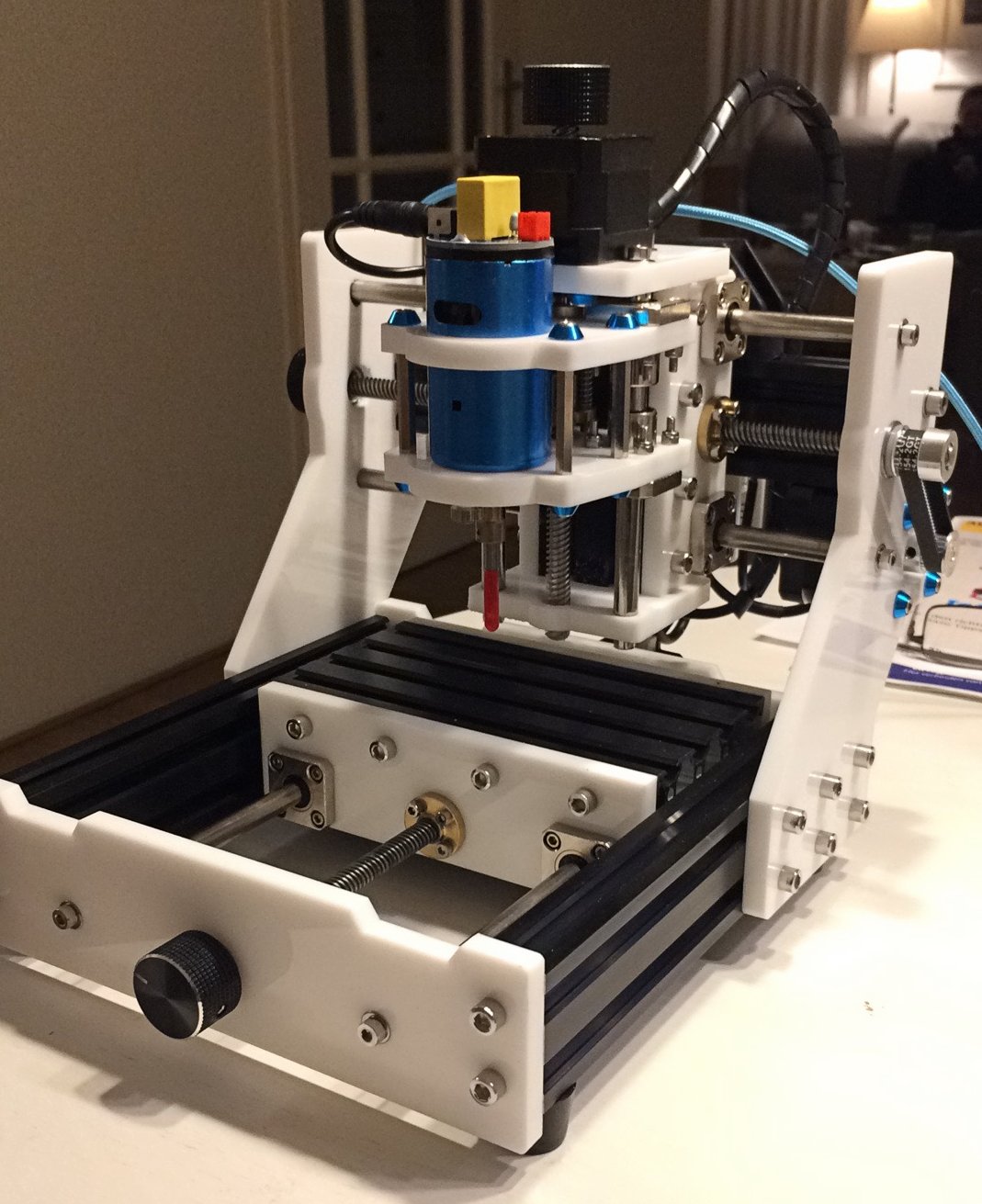

To play really nice I had to find some good software, since the EleksMaker soft is real crap.
As I also want to use the little baby for milling PCBs, I looked and found a Plugin for CadSoft's Eagle which produces nice clean GCODE. For operating the machine I used the Universal GCODE Sender...

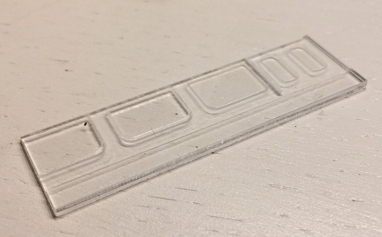

Then I found CamBam...  ;D ;D  Took the 40x run free trial, and immediately was impressed with it. I made some train-window-glazing from clear 1.5mm acryllic... just using CamBam's GCODE uploaded by UGS.
