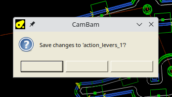

Are you able to reorder items in the Drawing tab (particularly the order of machining operations) by dragging and dropping them? Nothing happens when I try to drag an item.
Other things are broken too, e.g. several dialog boxes have blank buttons.

Because things work for me I am still with Ubuntu Mate - 18.04.5
As for Mono, I have frozen it at version 5.12 because after that funny things started to happen with font sizes.
Yes, I can drag MOP's. Inside the part or between parts.
One thing that doesn't work is copy/paste a Trochoidal pocket MOP. I suppose this is because it is external to CamBam, developed by a user. In Windows copy/pasting it works though. The MOP itself works in Linux.
