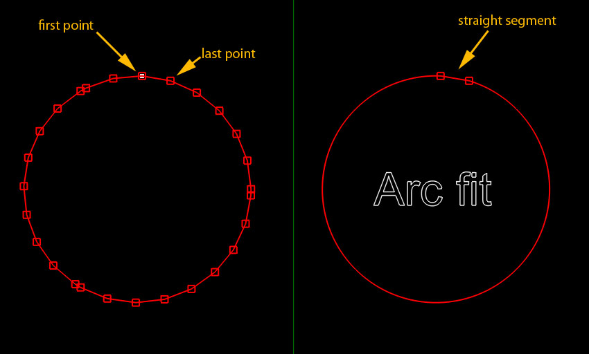

1. - Silhouette created circles are not true circles (Polyline and Arc). Even when the source is a Circle.
Silhouette works only on meshes, so because the STEP files are converted to mesh surfaces when imported in CamBam, you necessary get segmented 2Dshapes as on a STL file even if it was a circle in the STEP file.
A know problem is with the "arcfit" function that can be applied on a "circle like" segmented shape ; when used on a circular shape made from straight segments, only the segments defined into the collection of points of the polyline are converted to arcs, but the last one, that is added between the last and the first point of a polyline when it is marked as closed is never replaced by an arc and remain as straight line. Maybe it is the problem you encounter ; did you have an arcfit somewhere in the code ?
