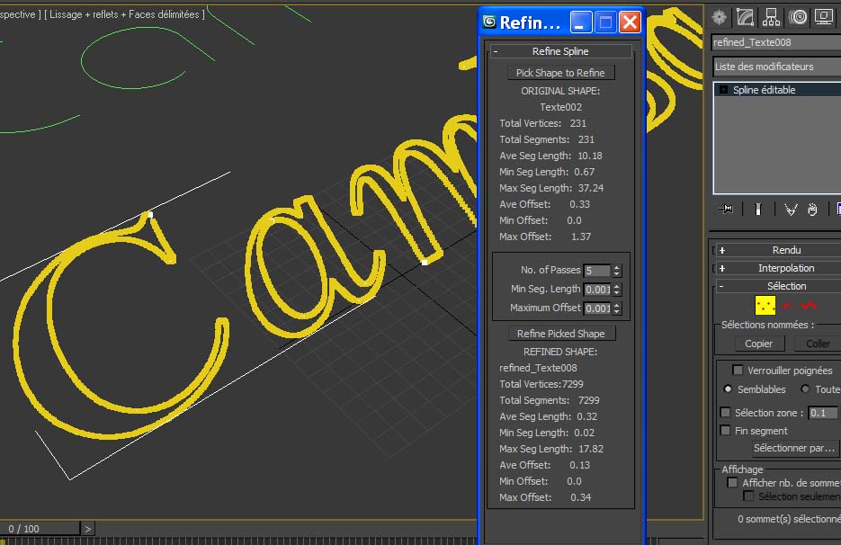

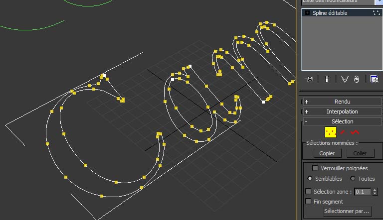

The Wrapper script converts all arcs to lines, and you must have a very detailed shape to get a good result (Wrapper don't add control points).
You must first use "refine spline" to obtain a detailed shape.

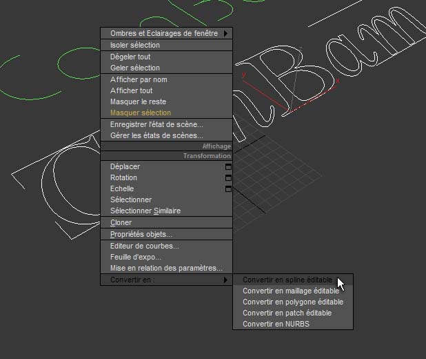

I convert the text in spline before, but it's just to show the control points. …. there are not enough
I must refine the spline.

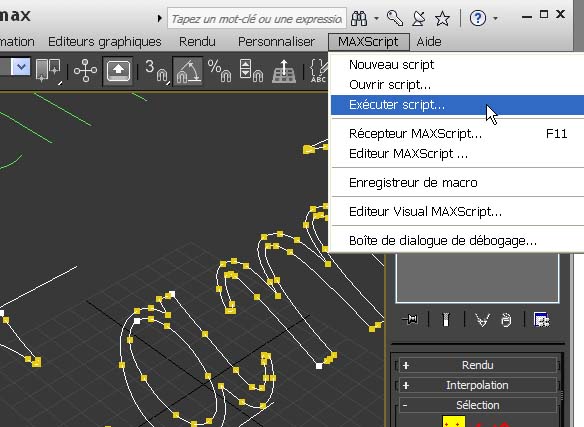

Use the MaxScript main menu and select Run script, then browse to the directory you have stored the two scripts and open "refine spline"
Clic on "pick shape to refine" and select the spline you want to refine.
You get some info about vertices and segments.
set a suitable value in each 3 rolout and clic "Refine picked Shape"
you can compare the result to the original spline.

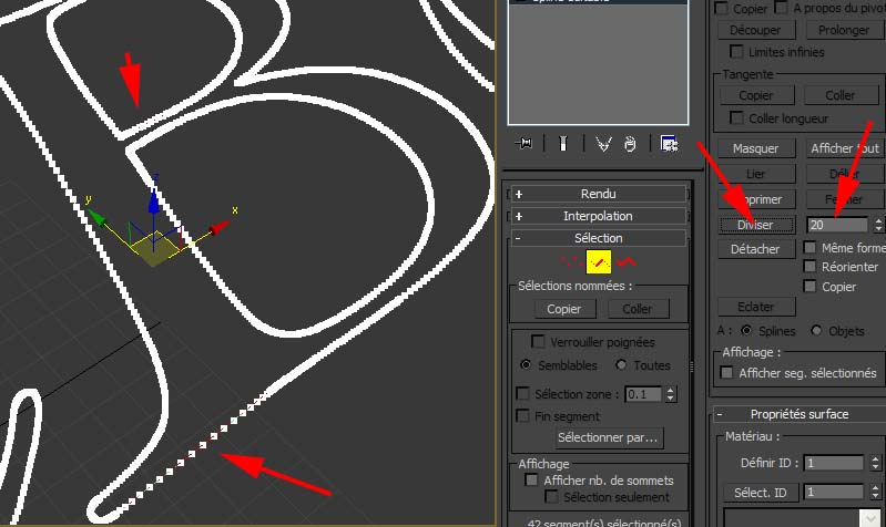

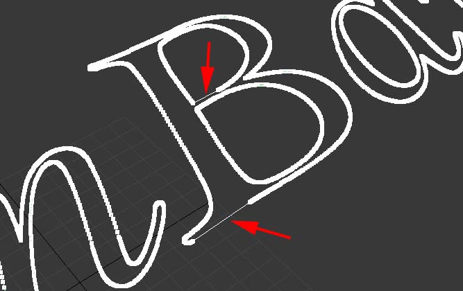

sometimes, on strait lines, you get long segment that must be manually refined.
In edit mode, select the segments and use the "divide" button after setting the number of vertices you want. (20 here)

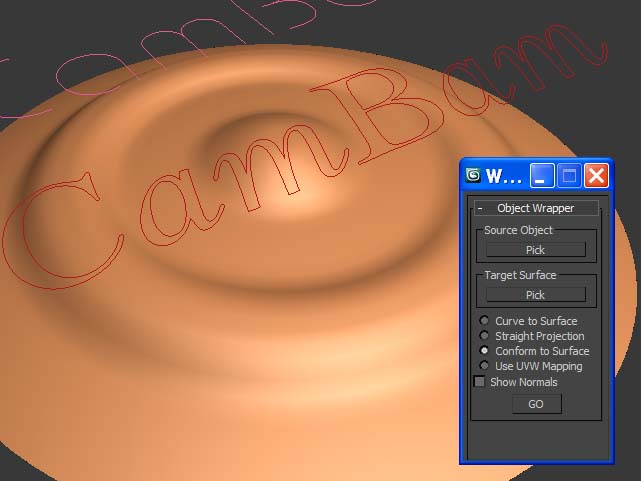

Refine is done, and now I can wrap the spline on the surface.
Use the MaxScript main menu and select "Run script", then browse to the directory you have stored the two scripts and open "Wrapper"
Wrapper is very easy to use, click on the "Pick" button below "Source object" and pick the spline, then do the same thing to pick the mesh with the second pick button, select "Conform to surface" and clic on GO to run calculation.
You get a new wrapped spline on the 3D surface, the original spline is not altered.
the result

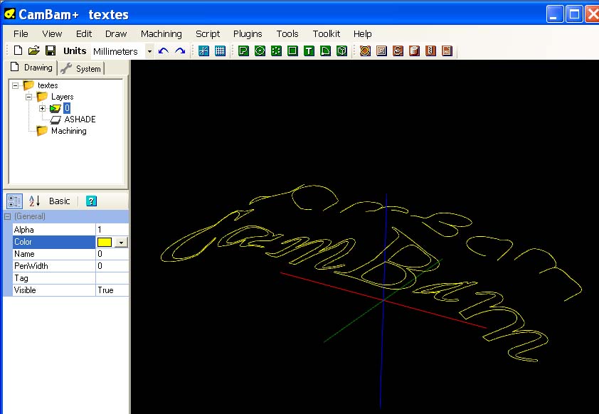

You can now open the two files in Cambam, first open then DXF
Then use Draw/Surface/From mesh file to insert the 3D mesh.
Now, you can set an engraving MOP to your texts
