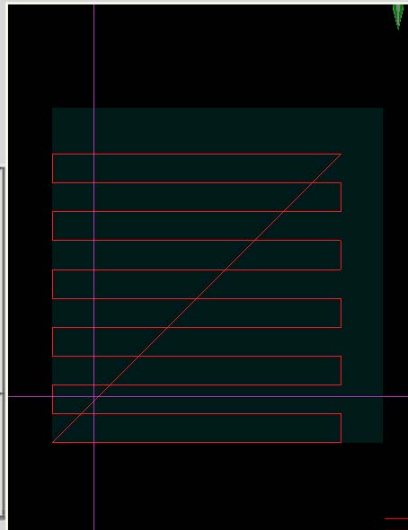

The G31 triggers the descent of Z; when the entry of "digit" is activated by contact with the object, the coordinates are saved in text file.
Here is an excerpt of this text file, with the X, Y and Z of each scanned point on a line.
0.00000,0.00000,0.00259
4.99917,0.00000,0.00259
10.00458,0.00000,0.00259
15.00375,0.00000,0.00259
20.00292,0.00000,0.00259
The zigzag scan is performed as shown in the image below.

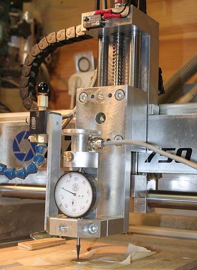

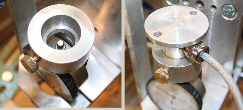

Mounting of the probe

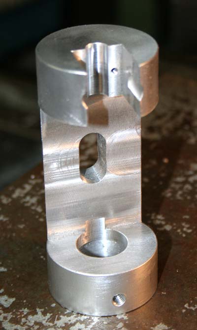

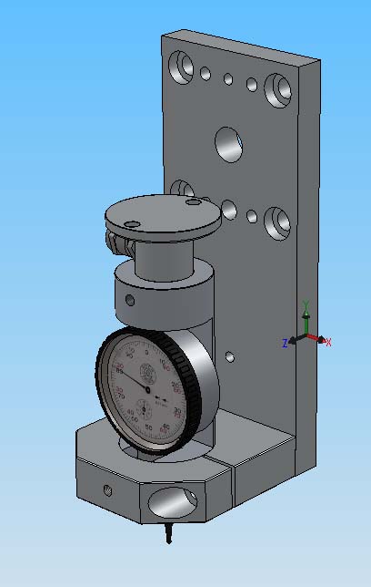

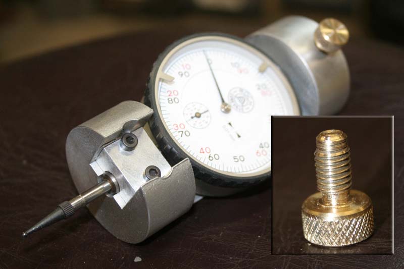

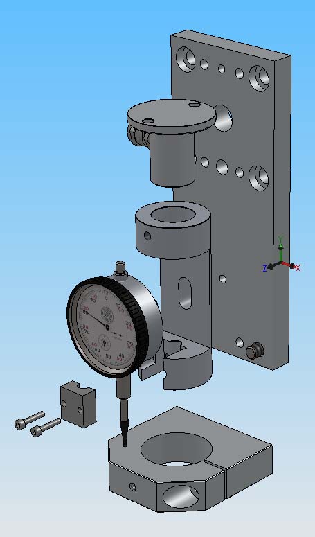

In my case, I simply used my touch probe, mounted upside down and is operated through the back of the stem of the guage, which in this case, only serves as a "accurate movable rod ". This arrangement may of course also be used only with the guage for other uses.
Here the assembly into 3D images
.... and actual parts ....
mounting on the machine ....
and then a test on a mouse.
