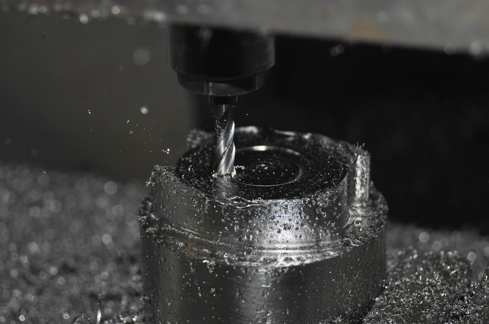

Just did a test.. just surfacemilling the Titanium Bar i'm using to make the case.. 10000 Rpm's.. that's as slow as my machine will go.. 4 mm Carbide endmill, 400mm/min Feed, 0.5 mm D.O.C.. smooth as a baby arse.. really nice chips..real chips, not dust.. they're shiny as the balls in a christmastree.. this is the sort of thing that makes me a happy man.. one Titanium Watchcase on the way..
i cool with Lamp-oil... misting.. goes perfectly..me's happy! ;D

Okay, Take out your little workshop notebook, and write down.. 120m/min Cuttingspeed, 7.5µm/tooth

Surprisingly.. the Kress motor has titanium for breakfast.. i can machine it on the lowest RPM's, still 120 m/min.. but when cutting 0.25 deep instead of 0.5 i can go 2½times as fast.. 1000mm/min.. that's 0.025mm/tooth. quite impressive..

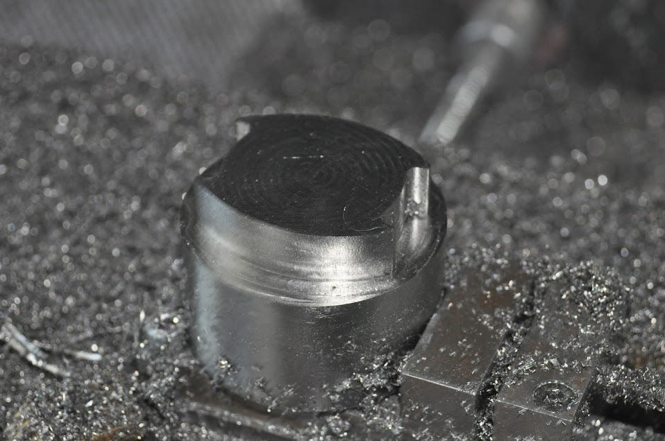

Then.. milling the outer contours.. CamBam did a great job.. i first roughed out with 0.3 mm stock..then 0.1, and finally a total depth finish..
and that gave me this result.. a little vibration visible.. will be ground and polished away.. will not perform total depth finishing again. this was a test.. this is the first time in my live i ever machined titanium..
Then.. onto machining the bottom and inside.. see the chips flying!.. Jay!..
The first recess cut.. this will become the thread..
and.. after some more noise, and a lot of chips..
the inside is now finished.. only the thread has to be made now.. but for that job i will have to change my mills.. will do that later this week..
