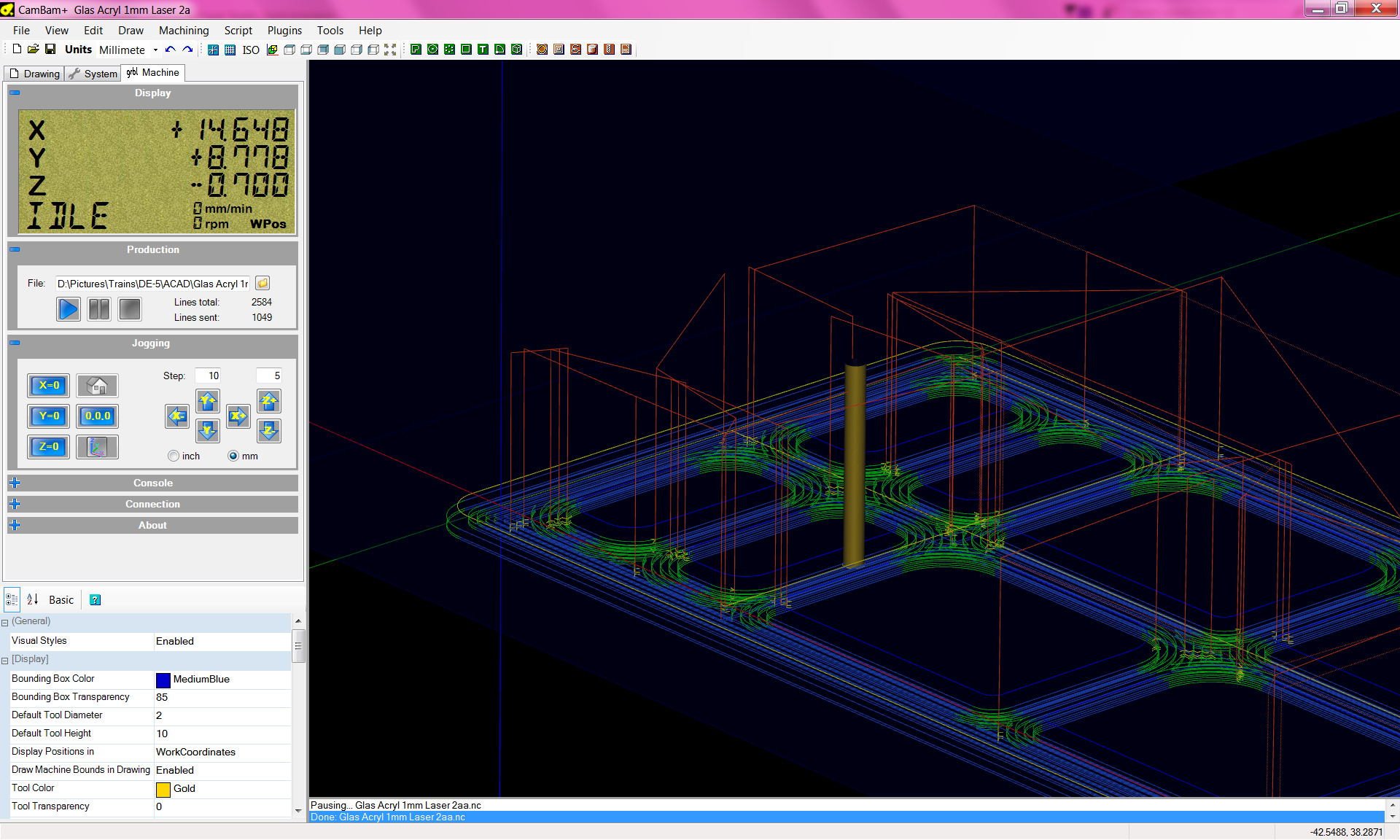

Next to some enhancement/fixes in the main part of the plugin, I added ( I think :P ) an awesome cool feature...
(click for the full picture)
The plugin can now, in realtime, track the movement of the machine's tool in the CAD-View :) 8)
In addition it is able to show the machine's bounding-box ( that is Maximum Axis Travels ).
Of course you can enable/disable all these features from the property inspector ;) (Tip: Press the 'Advanced' button and walk through them ... )
I use this feature with the steppers off, but the Arduino powered to check my GCODE.
Workflow:
- Load a drawing,
- Switch to ISO view-mode
- Press ^T ( Generate and display Toolpaths )
- Press ^W ( Generate GCODE )
- Turn on 'Track Machine Tool in Drawing' in GRBLMachine
- Turn on 'Draw Machine Bounds in Drawing' in GRBLMachine
- Jog to your origin with GRBLMAchine
- Set your 0,0,0 point
- press 'Play' in the production-Expander
Known Issue: The bounding-box is still always in Millimeters ( GRBL defines them that way ;) ) so when you have a drawing in Inches, your displayed bounding box will be off by a factor of 25.4 too large ;)
Suspected Issue: With Homing Cycle enabled, it might be that the boundingbox is not in the correct position. As soon as I have my limit switches installed, I will know ;)
Well, that's it for now, here is a little movie how it shows up:
