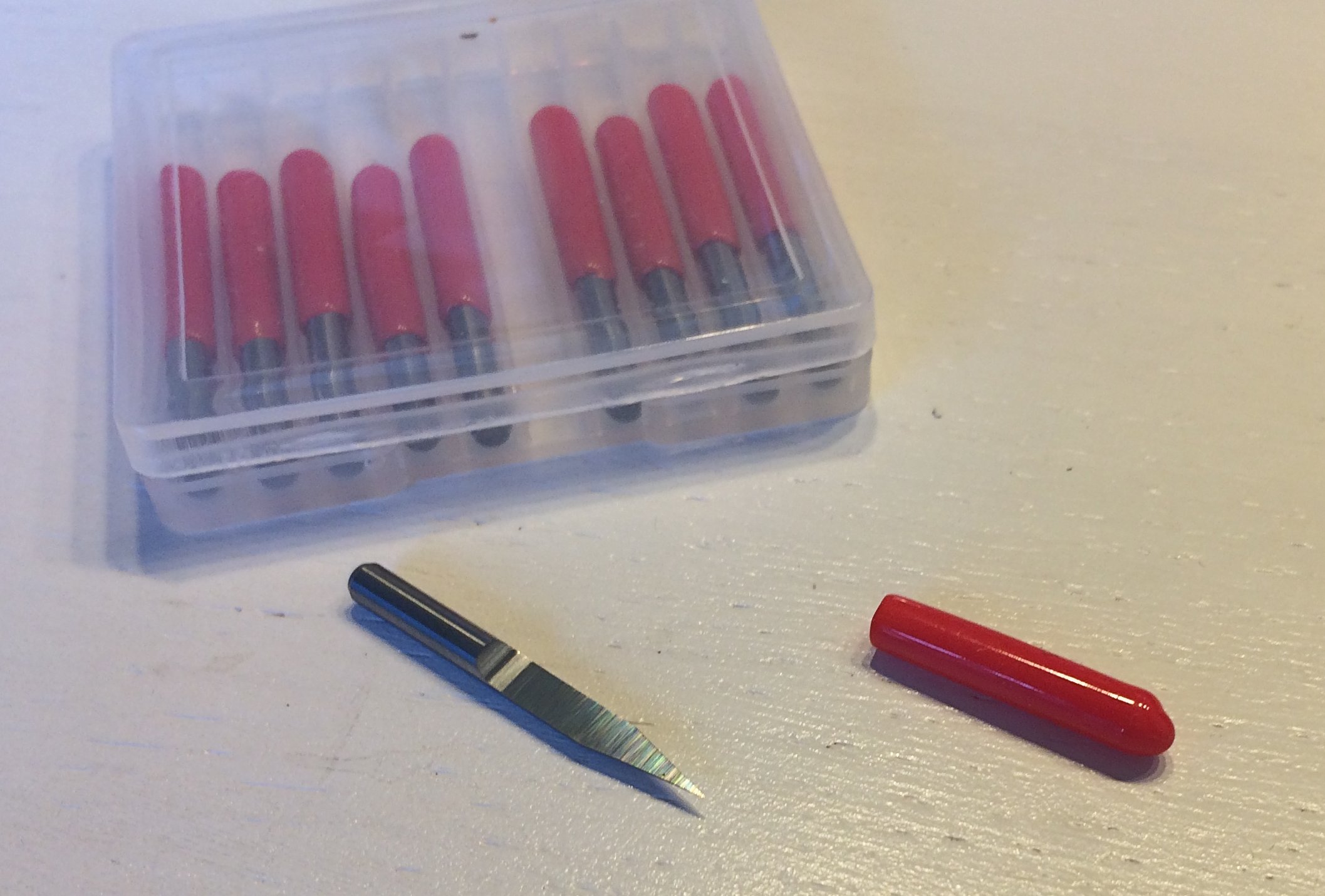

Also, the VBits they include, are they 45 or 60 deg?
Offline karst.drenth
  • Droid
  • Posts: 59
Re: GRBL v1.1 Machine Control and GCODE sender Plugin
« Reply #83 on: April 04, 2017, 06:23:23 am »
Hi,
Thnx for the compliment !  8)

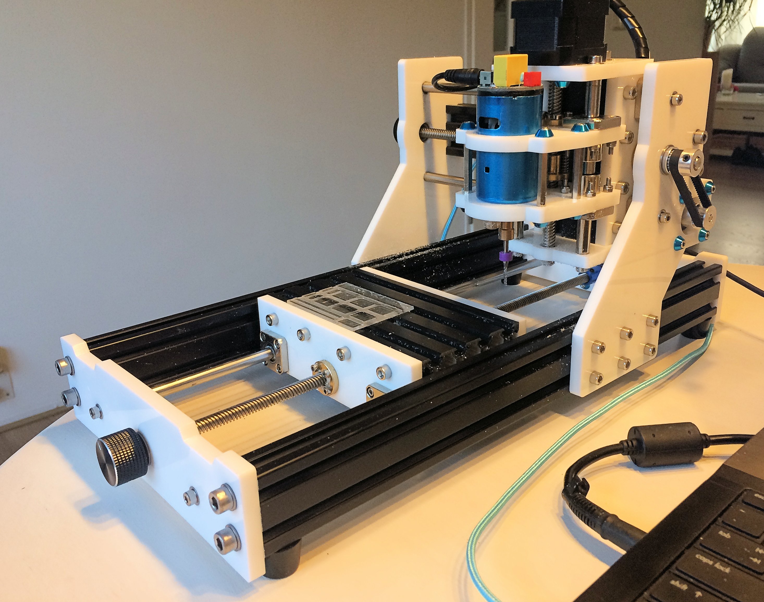

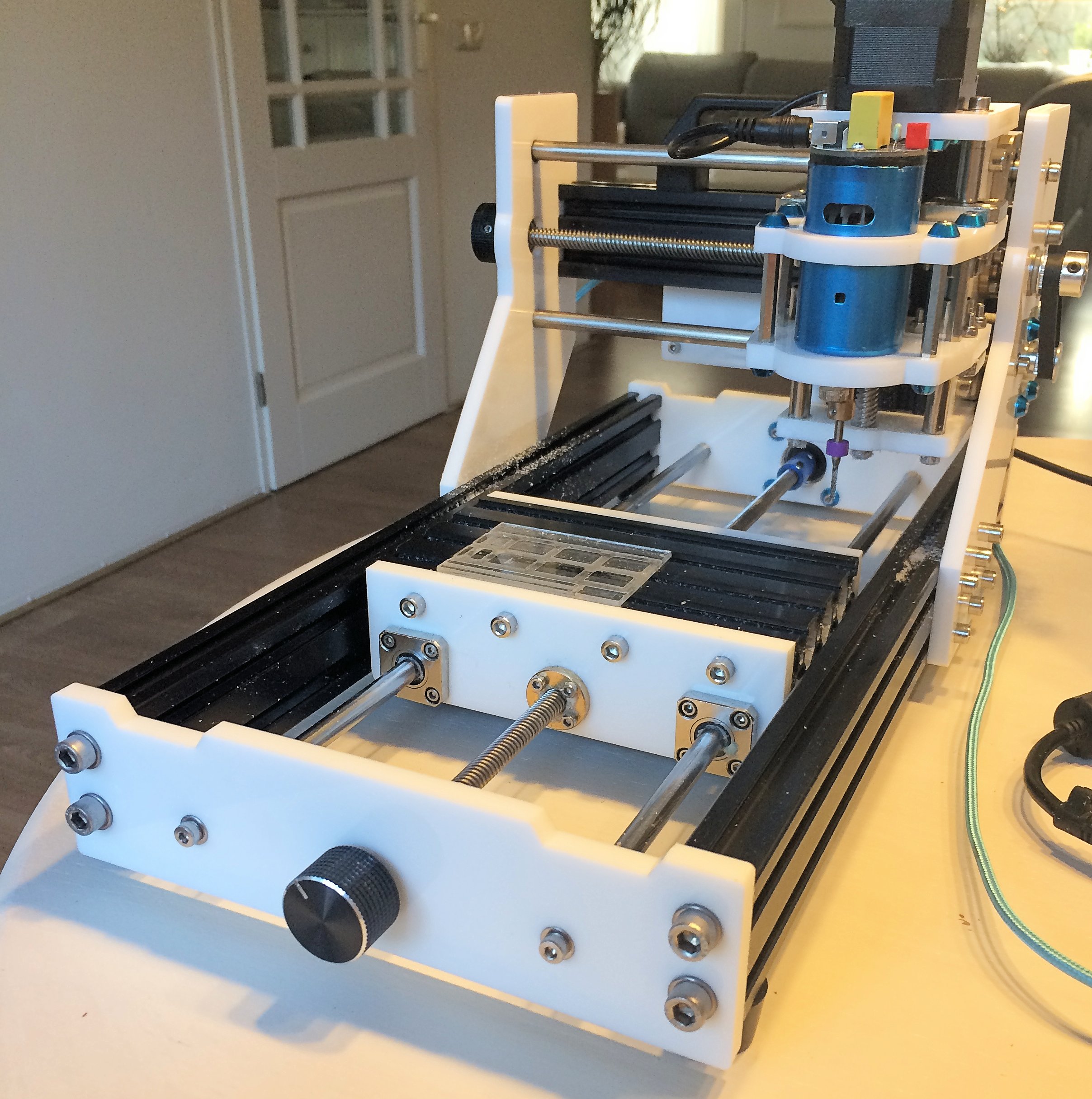

Well, in the meanwhile I 'extended' my EleksMill a little bit ...
... I replaced the complete Y-axis with 400mm long parts from AliExpress. Rendering a lot more travel in that direction.
However rigidity suffered from that and therefore the milling capabilities degraded even further. I also tried the laser.
... that one is really nice, used it to cut sticky foil. Somewhere this or next week I'll post that work in 'Member Projects' ;)
But... a 3040Z-DQ is on it's way into my workshop. ETA tomorrow afternoon  ;D ;D Then I can do some real milling. But not before I have made a GRBL-to-Parallelport converter ( No parallel port present on my laptop...) In that way I can continue using CamBam + GRBLMachine instead of Mach-3 :P :P
Anyway,
... the V-Bit are about 20 degrees and merely engraving bits.

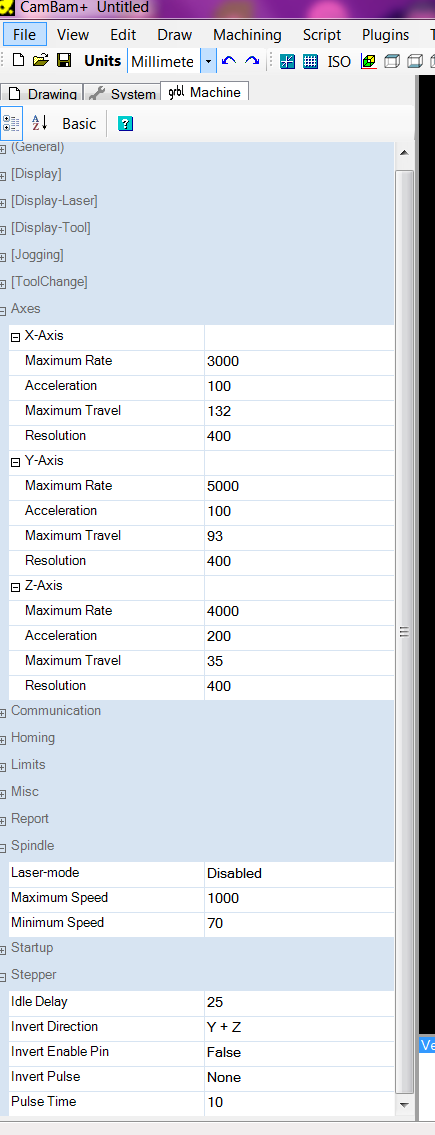

My Eleksmill settings:
... aside from the Axis parameters and dome direction bits, it is still default as Grbl v1.1 comes out of the box.
In text:
Code: [Select]
**** Connected to COM170 @ 115200 baud ****
Grbl 1.1e ['$' for help]
>G21F100:ok
$0=10
$1=25
$2=0
$3=6
$4=0
$5=0
$6=0
$10=1
$11=0.010
$12=0.002
$13=0
$20=0
$21=0
$22=0
$23=0
$24=25.000
$25=500.000
$26=250
$27=1.000
$30=1000
$31=70
$32=0
$100=400.000
$101=400.000
$102=400.000
$110=3000.000
$111=5000.000
$112=4000.000
$120=100.000
$121=100.000
$122=200.000
$130=132.000
$131=93.000
$132=35.000
ok
