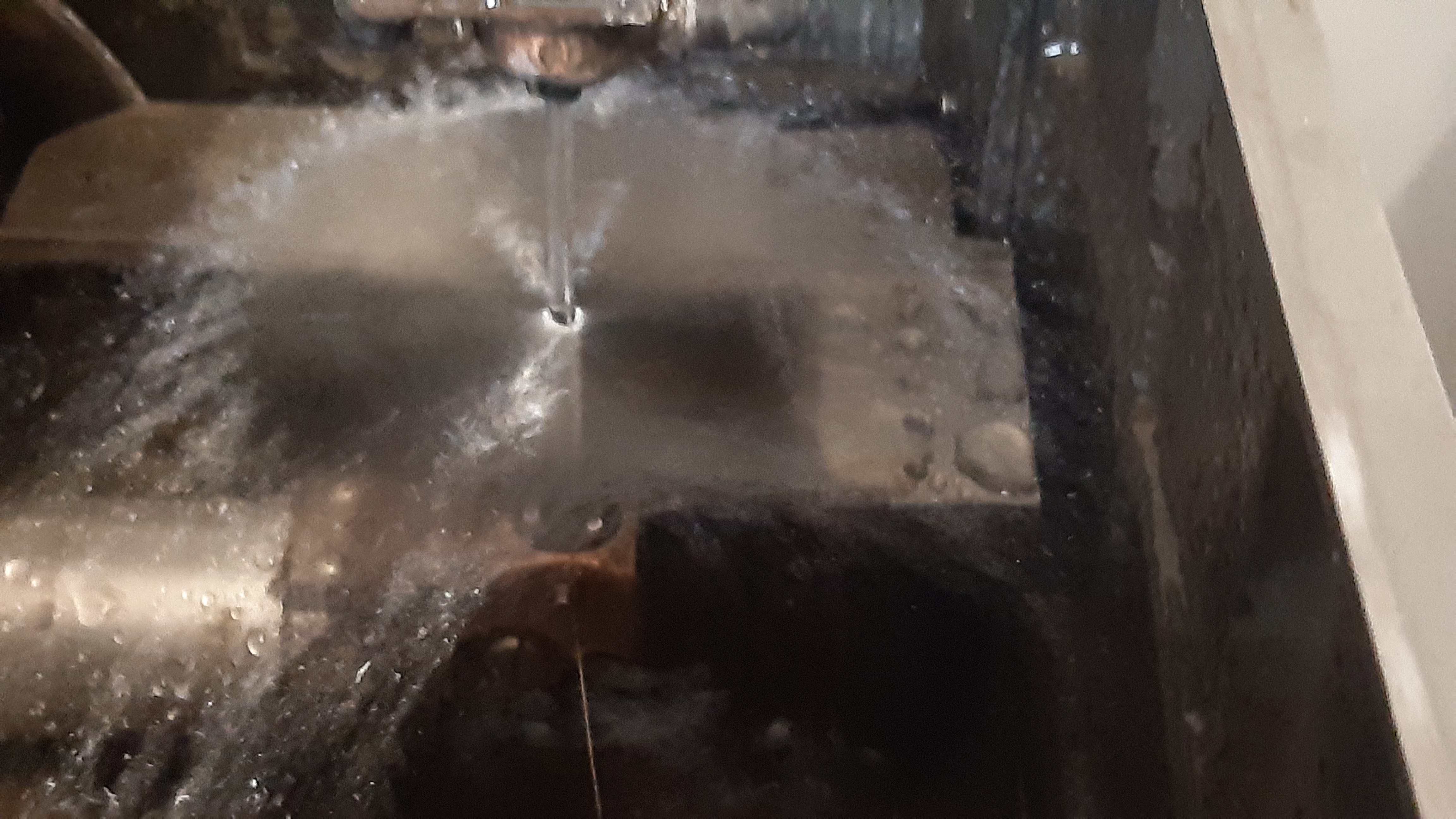

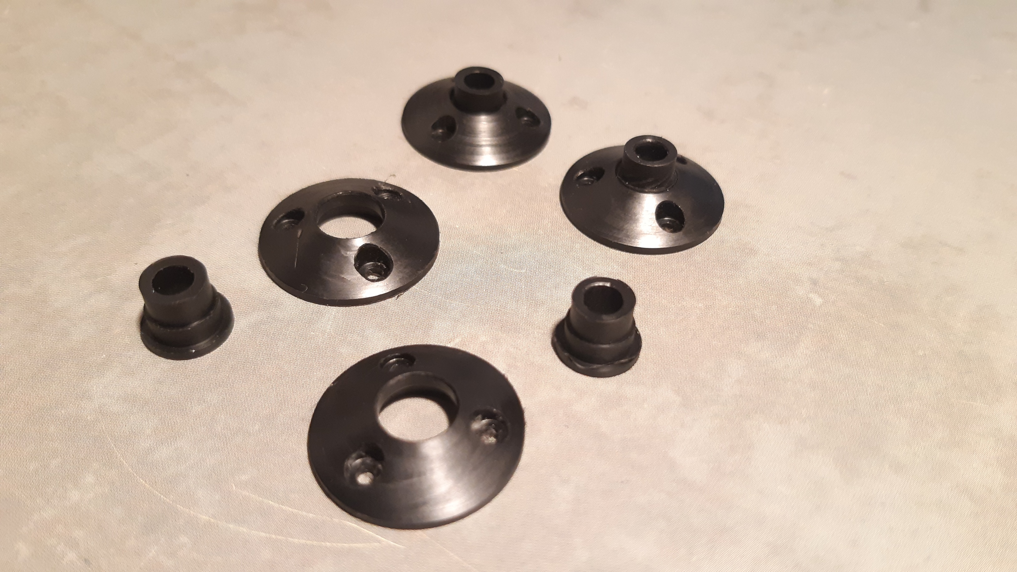

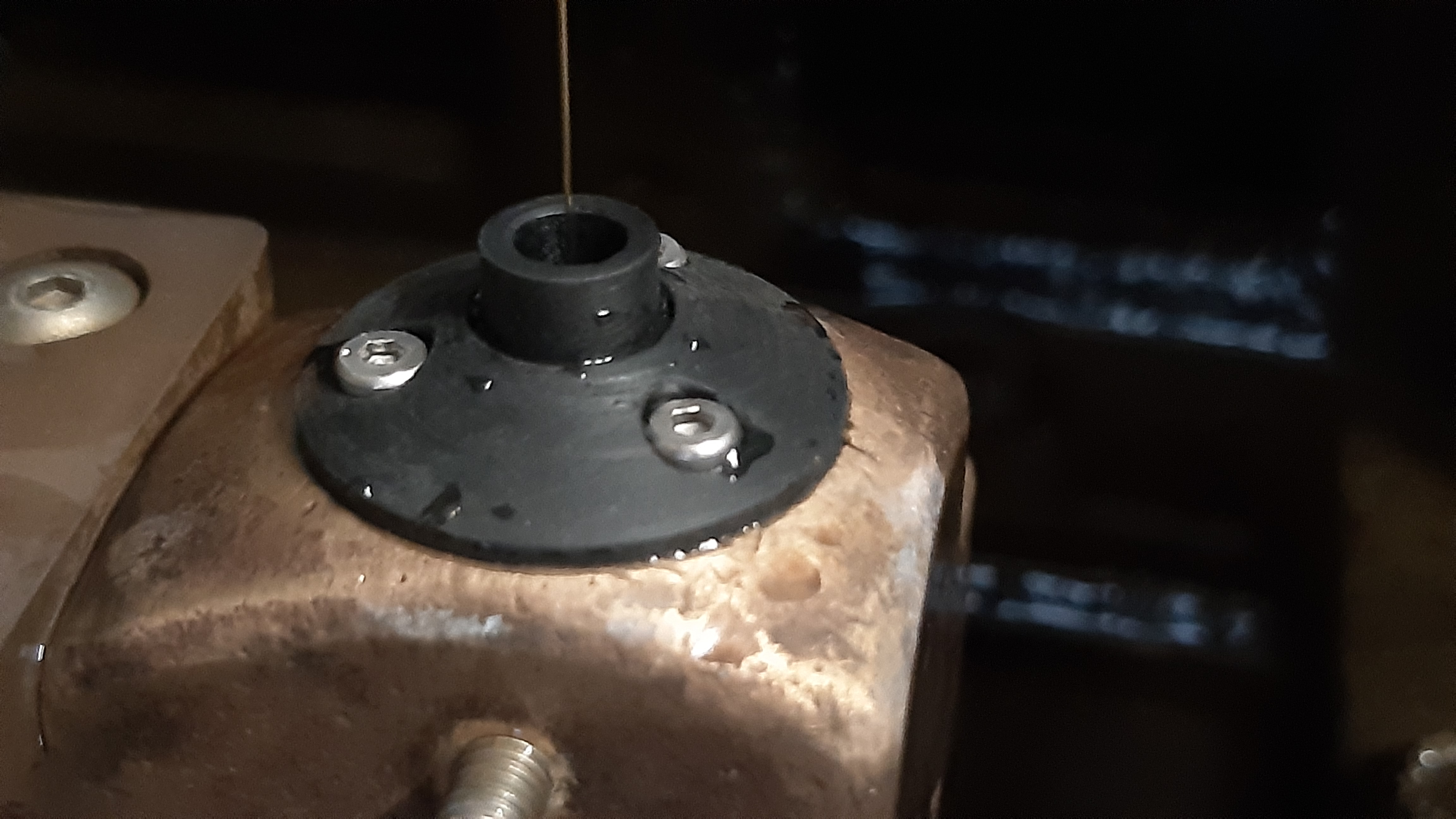

I  made some new nozzles for the machine as well..
I had to drill and tap new holes to fit them, as the old ones had deteriorated..3 holes M2.. Hurray for my CNCmill  ;D
and..
Mounted in the machine..
Now to test..
And we have a nice fountain in the machine.. the Jets from top and bottom are perfectly aligned, giving this "umbrella" of water at 50 mm above the table..
I have never seen a Brother HS-100 do this..
