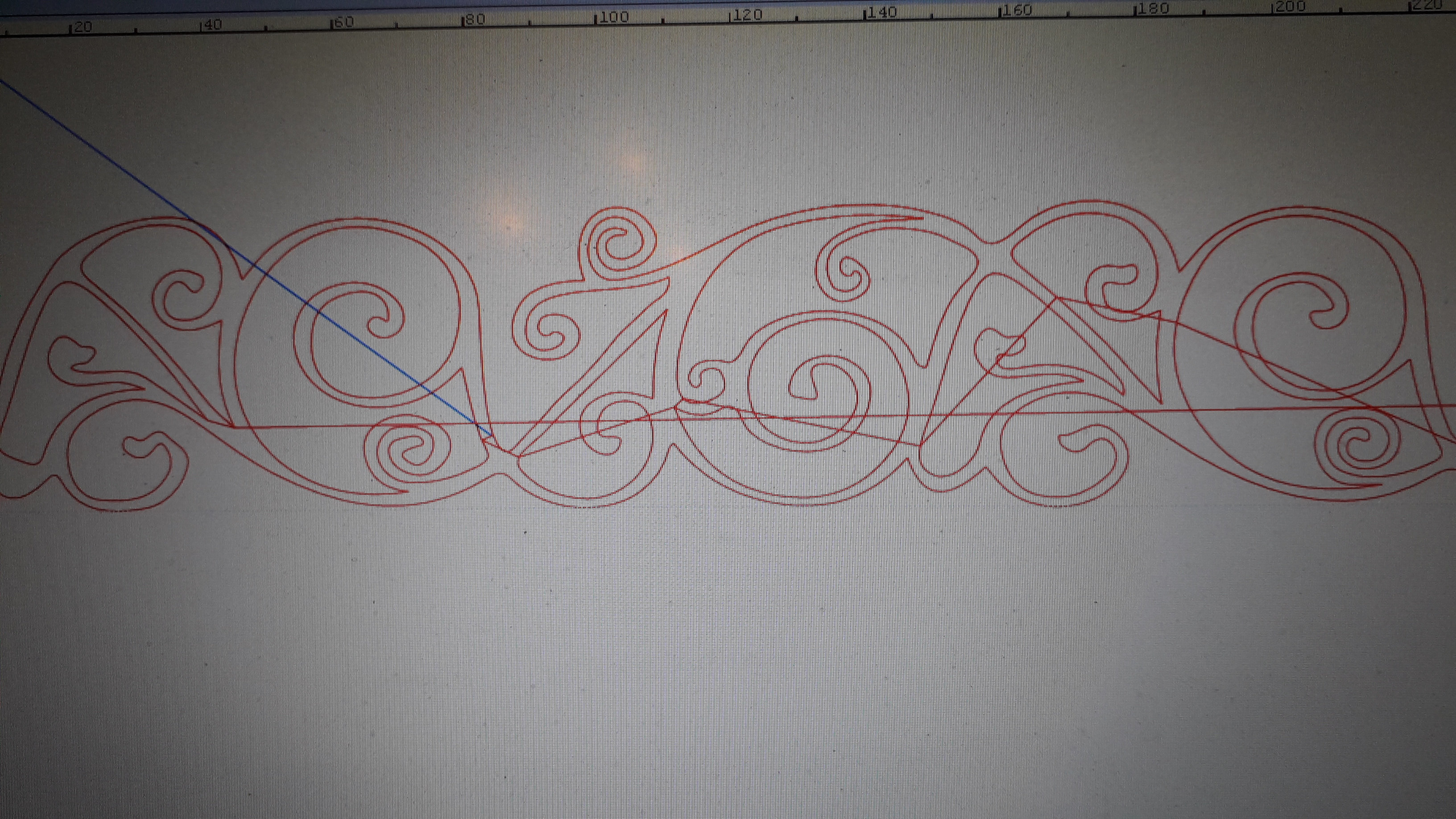

Hello hello,
I have a chinese CNC (ELEKSMAKER) running with the soft LASERGRBL V3.8.0.

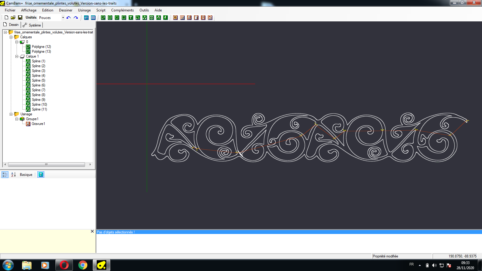

The problem is that when i create the Gcode with Cambam and export it in LaserGrbl the toolpath appears and my cnc engrave it !!!
An idea of how i can fix that?
Thx and have a nice WE!!!
Rom1

Hello
To avoid lines between the characters, you must:
- set max crossover distance to 0
- use a GRBL laser post processor
- set the values for stock surface, target depth and clearance plane correctly because it's  the Z position of the laser that define if laser must be ON or OFF.
have a look on this post
https://cambamcnc.com/forum/index.php?topic=8568.msg68145#msg68145

Thx a lot for your help!!!
It works fine for me :)
