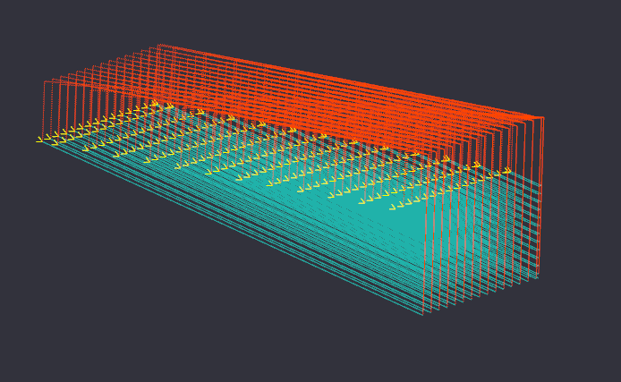

This script was created in response to query on how to generate a toolpath for a slot that slopes along the Z axis.
The script will generate a sequence of polylines that can be used as the source for an engraving operation.
The script was extended so that it can also produce a series of parallel sloped lines to machine a sloped surface.
The following parameters are used to control the script:
x1, y1 : The coordinates of the first control point.
x2, y2 : The coordinates of the second control point.
Target Depth : The deepest Z coordinate of the slot or surface.
Depth Increment : The maximum depth per cut.
Width : The width of the surface to cut. Use 0 to machine a slot. The tool diameter is not taken into account.
Stepover : The distance between each parallel cut for a surface.
Once the polylines are created, select them all, then insert an Engraving machine operation.
The engraving operation should have Target Depth set to 0 and Optimisation Mode set to None,
so that the machining operation will follow the source polylines exactly, in the order they were created.
