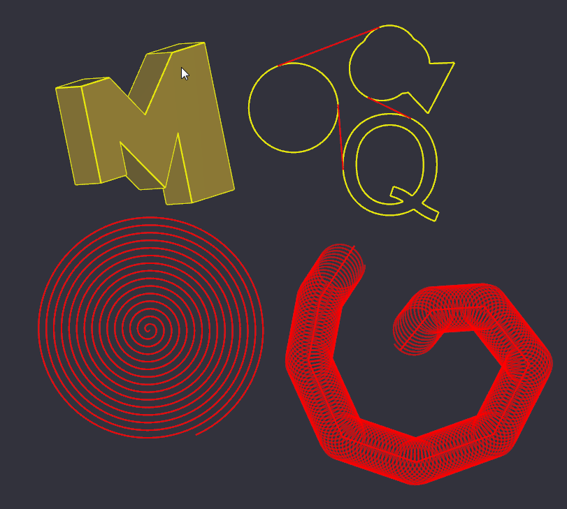

Draw - Tangent
Draws a single line segment that 'snaps' to circles and polylines.
A triangle icon is displayed at the tangent points and the end points should 'snap' to these.
Draw - Flat Spiral Draw
Draws a flat spiral polyline (spiralling inside to out).
Prompts for stepover (distance between each loop), and the spiral direction.
This may be of use to people experimenting with fast machining methods by using the spiral as a toolpath with an engraving operation.
Draw - Spiral Path Draw
Another flattened spiral polyline, but this time with constant radius moving along a path (specified by first selecting a shape for the spiral to follow).
Again this may be of use for high speed machining experiments or decorative finishes.
Draw - Trochoidal Path Draw
Similar to 'Spiral Path Draw', but implemented as slightly overlapping trochoidal C segments.
Intended for high speed machining experiments.
Draw - Ellipse
Draws an ellipse within a bounding rectangle.
The ellipse is comprised of small line segments.  To convert to arcs, use the Edit - Polyline - Arc Fit command.

Surface - Edge Detect
Will dump edge lines detected from selected 3D meshes.
These are triangle faces edges that have no neighbours, or the neighbouring face forms an angle.
