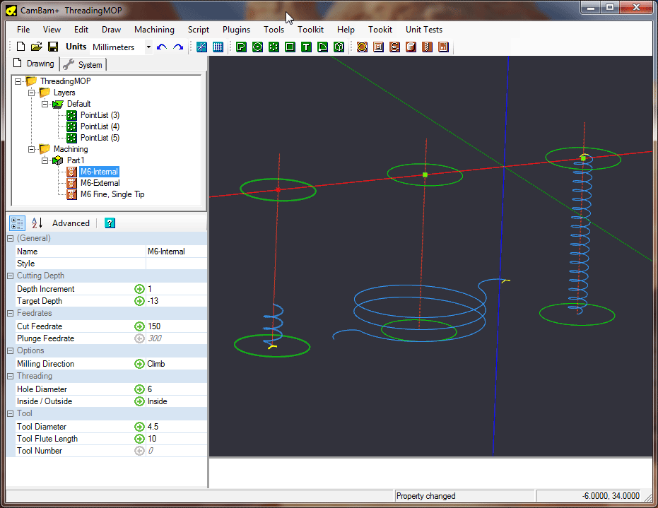

Thread Milling MOP examples
Usage
The thread milling operation behaves similarly to a spiral drilling operation and can be based on point lists, circles or other drawing objects (for these, the center point of the selected object will be used).
The thread milling operation assumes a clearance hole has been previously drilled to the required minor thread diameter.
The machining operation will generate a spiral toolpath with the pitch of the thread set in the Depth Increment property.
TPI pitch values need to be converted to a distance measurement (for example 25 TPI set Depth Increment = 0.04 in).
The diameter of the thread is set in Hole Diameter. For internal threads, this should be the major diameter of the required thread. For example, for an M8 thread, Hole Diameter would be 8.0.
For external threads, the minor or core diameter of the required thread should be used.
A helical tangent lead in and lead out move will always be inserted. The lead moves will ramp one half pitch in Z height. The lead out height should be taken into account when setting the target depth. So if a 1mm pitch thread needs to be cut completely through 10mm stock, the target depth should be set to -10.5mm.
For internal threads, the toolpath will start from the center point of the hole. For external threads the tangent radius is currently fixed at half the tool diameter.
Bottom-up or top-down thread milling can be controlled using the Milling Direction property.
For example, if Spindle Direction is Clockwise, setting Milling Direction=Climb will result in a bottom-up cut
A multi-tip thread mill can be specified by entering in the Tool Flute Length property; for a single tip cutter this can be set to zero. For multi-tip cutters (or when bottom-up machining), the tool will be lowered into the center of the hole using the plunge feedrate, down to the staring point of the tangent lead in. A minimum of 1 spiral loop will be used and multiple loops will be inserted if the flute length is less than the target depth. To intenionally mill more than a single loop a smaller value than the true flute length may be entered.

The depth increment controls the pitch of the thread being milled.
This is the depth of cut for each loop of the spiral.
