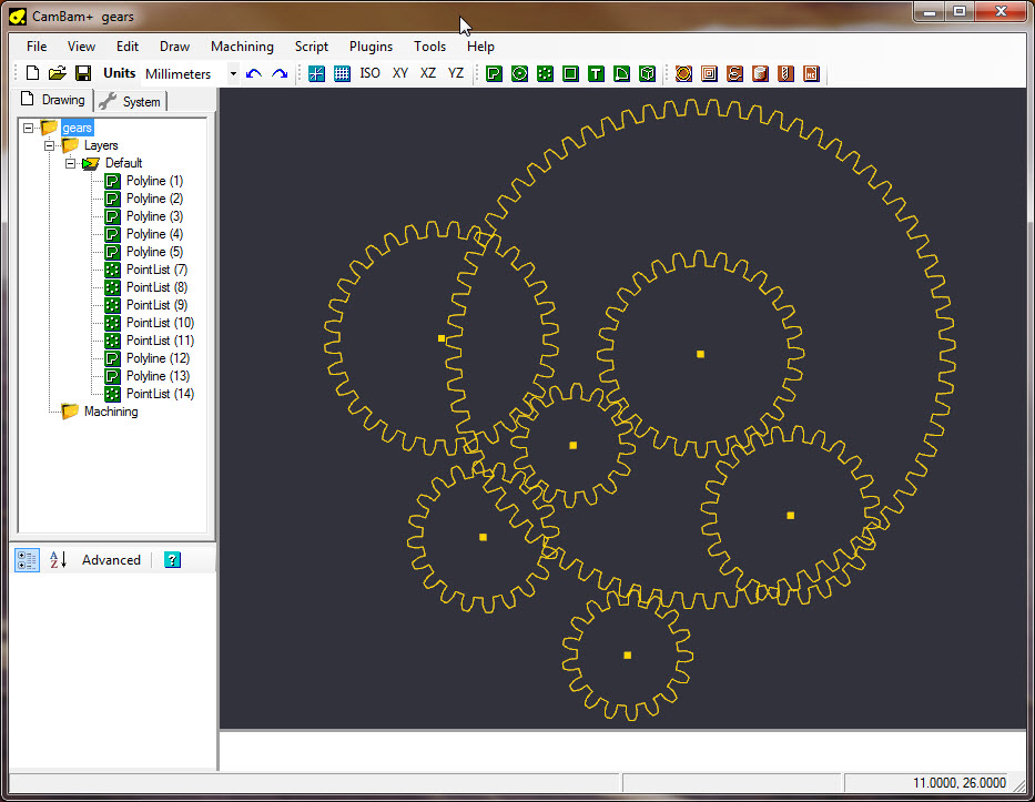

This script takes a pre-drawn group of gear outlines (generated using the CamBam gear generator), then
animates them using a series of relationship rules within the script.
This script requires CamBam 0.9.8N or later.
This script demonstrates:
- Importing a helper Python module.
- Defining a Python class.
- Animating objects by changing their transformation property.
