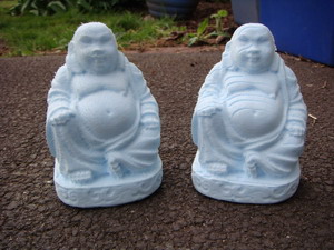

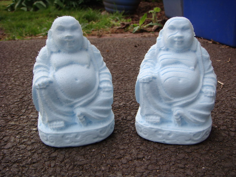

New 3D Profile
The left hand buddha was finish machined at 2000mm/min resulting in a fuzzy finish (but total run time was only 45 minutes including a 3mm depth roughing pass and 0.3mm finish stepover). A faster spindle speed should have been used for the finish. The right buddha had a slower finish speed but the tool was referenced incorrectly resulting in roughing gouges. Practice makes perfect!
These files were made from a 1.5M face model from the wonderful Aim@Shape Shape Repository, down-sampled to 30K faces using the equally marvelous MeshLab application.

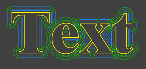

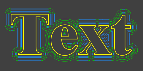

OpenGL drawing view.
The OpenGL view now supports the ShowCutWidths=True machining option. The cut width shading is now generated using a more sophiscated approach than the old GDI routines. One main benefit is the cut widths can be viewed from multiple angles rather than only face on as with GDI.
OpenGL mode is now enabled by default. If any problems are experienced with OpenGL, legacy GDI support can be enabled. In Tools - Options, under the Display group, there is an option DisplayMode which can be set to GDI or OpenGL. Changing this option will require restarting CamBam.

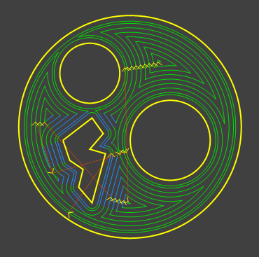

Draw - Fill Region
Region fillers are another development added to support the new 3D profiling routines and useful in other applications.
Region fillers are used to fill a shape with lines according to certain patterns. The lines can the be used to form tool paths (as with 3D profile waterline roughing).
Once the technique has been proved with waterline roughing, the intention is to change the existing 2D pocketing operations to use these routines.
The current region filling styles are:
  • Inside Offsets region filled with offsets from islands radiating outward.
  • Outside Offsets region filled with progressive offsets from outside in (like current pocket method).
  • Inside + Outside Offsets region filled with progressive offsets from outside in, unioned with offsets from islands radiating outward.
  • Horizontal Hatch region filled with horizontal lines
  • Vertical Hatch region filled with vertical lines

Toolpath collision detection (unioning)
I think the best way to describe this feature is with some pictures...
Overlapping toolpaths 0.9.3
Toolpaths for shapes close together would overlap in previous versions, resulting in overcutting
New toolpath collision detection
With collision detection, all toolpaths are unioned together, avoiding overcutting.
Another use for collision detections is for inside profiles for regions. This provides an alternative method for island pocketing which requires no 'clean up' pass around inner islands. This will be added as an extra option to pocketing operations.
Alternative Island Pocketing
This new feature also makes it possible to do better isolation routing files for printed circuit boards as previously increasing cut widths would over cut tracks.

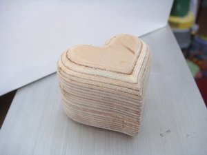

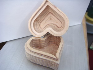

The samples folder contains a file 'side profiles.cb' which shows an example of all the permutation of side profile methods, value signs and inside / outside profiles.
Another example 'heart-shaped-box.cb' is also provided which uses side profiles.
Heart Shaped Box Heart Shaped Box

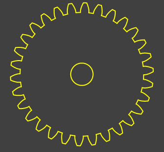

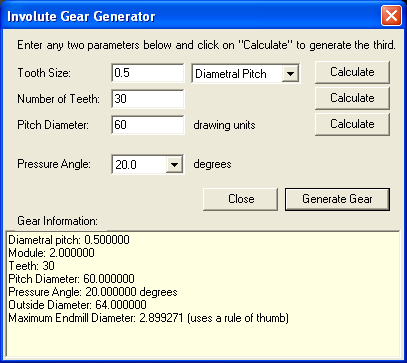

Involute Gear Plugin
With many thanks to Ajayre the CamBam plus toolkit now contains an involute gear generator. This is available under the 'Toolkit' top menu.
Involute Gear Plugin Involute Gear
