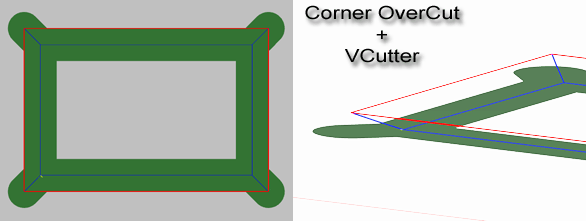

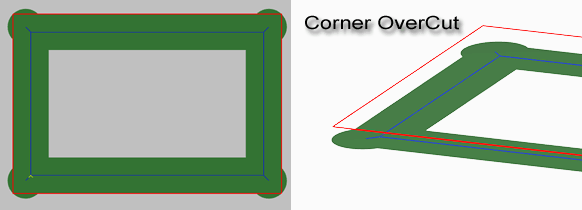

Corner overcut option.
Inside corners, where a tool diameter typically will not fit, can cause problems if they define a shape where another shape needs to be inserted into it, as with a slotted joint or inlay.
A new parameter: Corner Overcut, set to True or False can be defined, which will add an overcut in towards these inside corners.
If the Tool Profile parameter for a machining operation is set to V-Cutter, a ramped cut is inserted up to the stock surface, all the way into the inside corner. This can result in nice clean square corners when an appropriate V cutter is used.
The file snap-together-box.cb in the CamBam samples folder illustrates the use of corner overcuts to clear joints that will be slotted into each other.
The CamBam.cb sample file contains an example of a V corner profile in the last part.

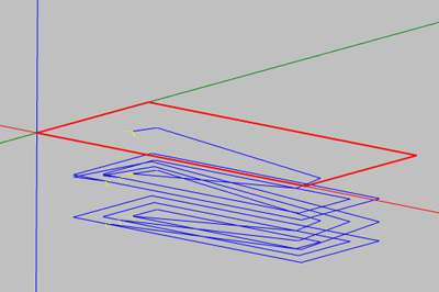

New spiral lead in behaviour and lead out option.
A Lead In Move with the Lead In Type set to Spiral is a useful way to specify a toolpath that gently enters the stock at a specified angle. In this release, if the spiral angle is set to zero, the Depth Increment is used to calculate a ramp angle, such that the toolpath will continuously spiral one depth increment in each pass around the object. In this situation, the lead in move replaces the original toolpath, so that the part will be cut in one continuous spiral feed.
An additional (non-spiral) toolpath is added at the final cut depth.
Lead In Type = Spiral + Spiral Angle = 0
A new Lead Out Move property has now also been added. Currently only tangential lead outs are supported.
The file continuous-spiral-feed.cb in the CamBam samples folder illustrates the use of both continuous spiral feeds and lead out moves.
