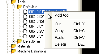

Managing tools
Like the other system libraries, new tools and tool libraries can be create from the context menus presented when right clicking the system tab's Tools folder and tool library sub folders.

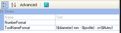

The following image shows the tools renamed using the following format expression.
{$diameter} mm - {$profile} - z={$flutes}
