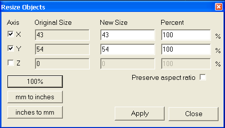

The Transform - Resize menu option (or Ctrl+E) is used to resize selected drawing objects.
![](/doc/plus/images/resize_win.png)
Each axis can be scaled separately by using the check box to the left of the axis label.
Unticked axis will retain their original size.
The Original Size column displays the current dimensions of the selected objects.
A specific size can be entered in the New Size column or a scaling factor entered in the Percent column.
If the Preserve aspect ratio box is checked, changing one axis will cause the other (enabled) axis to be scaled
by the same amount
Short cut buttons are provided for common scaling factors
- 100% will revert the objects their original size (100%).
- mm to inches will scale mm measurements to inches.
- inches to mm will scale inch measurements to millimeters.
Press Apply for the resize to take effect.

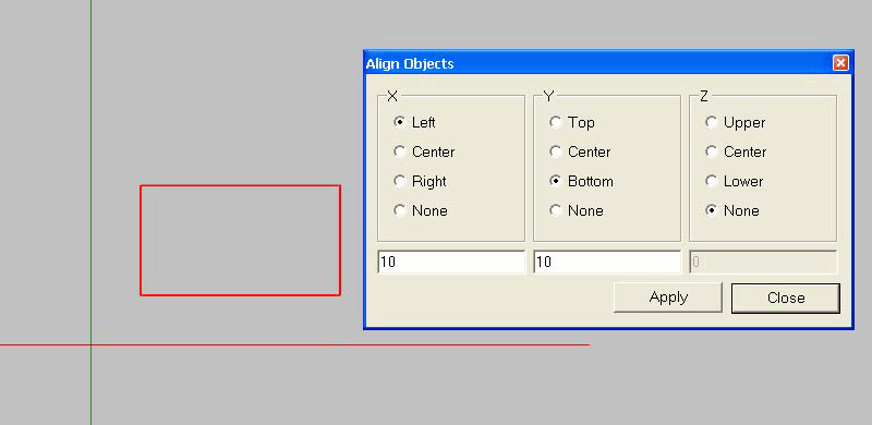

Align
Transform - Align can be used to position selected objects. This will display a form with 3 columns, one
for each axis. Select the point of the selected axis to align, or none to leave the current axis position intact.
Enter the drawing coordinate underneath which will be the new location of the alignment point, then press Apply.
![](/doc/plus/images/align.png)
In this above example, the left most side of the rectangle is aligned to X=10 and the bottom part of the rectangle is aligned
to Y=0. The Z location of the rectangle will remain unchanged.

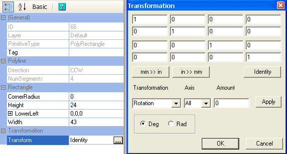

Transform matrix
More advanced transformations can be defined by changing the selected object's Transform property.
This is a 4 x 4 matrix which is used to position, rotate and scale the object.
The transform property is located in the object property window for the selected objects(s).
Click the [...] button to the right of the Transform property to open up the transformation editor dialog.
![](/doc/plus/images/matrice_trans.png)
Values can be entered into the matrix directly or a number of helper buttons can be used.
To rotate, scale or translate, select the required operation from the Transformation drop down list,
select an Axis that the transformation applies to and an amount, then press the
Apply button.
For rotations, the positive Z axis is coming out of the screen towards you.
If you place your right thumb in the positive Z direction, your fingers will curl in the direction of a positive rotation about the Z axis.
This right hand rule applies to rotations about all the axis.
Multiple transformations can be applied as along as Apply is clicked between each.
To reset the transformation matrix, click Identity.
