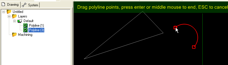

Edit
Modifies selected polylines by allowing the control points to be dragged interactively in the drawing view.
The polyline edit mode can also be entered by double clicking a polyline in the drawing view.

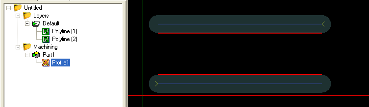

Reverse
Reverses the order of the points within a polyline.
Reverse is useful in situations where there is a toolpath such as a profile, offset from an open polyline.  For
open polylines, the order of the points within the polyline will dictate which side of the polyline the toolpath will be offset from.
As an alternative to changing the profile machining operations Inside / Outside property, the source polyline can
be reversed.  This will change the side of the polyline where the toolpath is offset.

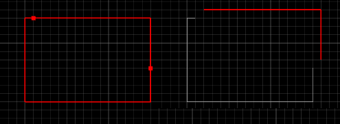

Set start point
Changes the first polyline control point, (for closed polylines only).

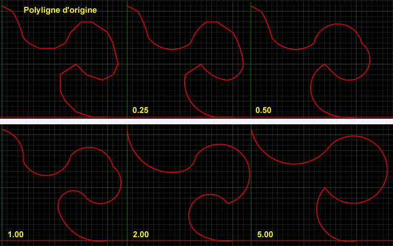

Arc Fit
Arc fit will attempt to simplify a polyline by replacing a number of small segments with a single circular arc segment, that fits
the polyline control points according to a specified tolerance.  In some cases this can dramatically reduce the number of segments
in the polyline, resulting in faster toolpath calculations and more compact gcode.  The use of large arc segments rather than
many small segments can also make the machining operations much smoother when cutting.
Arc fit will prompt for an Arc Fit Tolerance.  This is the maximum allowed deviation (in drawing units) from the fitting arc to the original segments.
A larger tolerance can result in polylines with fewer segments but the deviation from the original shape is potentially greater.
The following images show the effect of different tolerances on a polyline arc fit.
