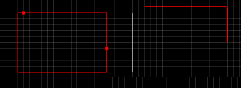

Edit Polyline
This section describes the operations available from the Edit - Polyline menu.

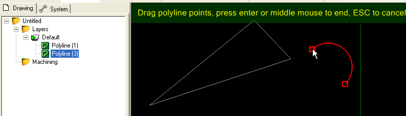

Edit
Modifies selected polylines by allowing the control points to be dragged interactively in the drawing view.
The polyline edit mode can also be entered by double clicking a polyline in the drawing view.

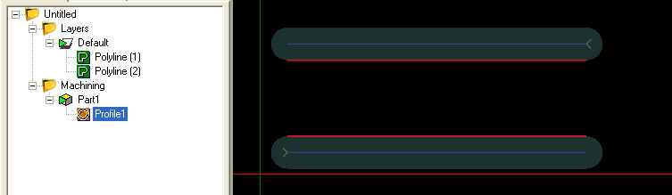

Reverse
Reverses the order of the points within a polyline.
Reverse is useful in situations where there is a toolpath such as a profile, offset from an open polyline. For
open polylines, the order of the points within the polyline will dictate which side of the polyline the toolpath will be offset from.
As an alternative to changing the profile machining operations

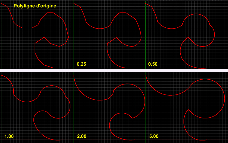

Arc Fit
Arc fit will attempt to simplify a polyline by replacing a number of small segments with a single circular arc segment, that fits the polyline control points according to a specified tolerance. In some cases this can dramatically reduce the number of segments in the polyline, resulting in faster toolpath calculations and more compact gcode. The use of large arc segments rather than many small segments can also make the machining operations much smoother when cutting.
Arc fit will prompt for an
The following images show the effect of different tolerances on a polyline arc fit.
