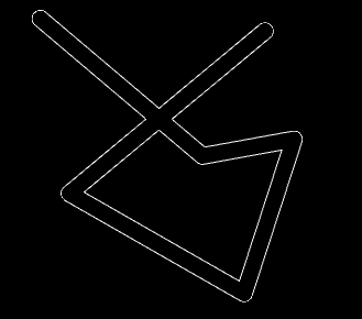

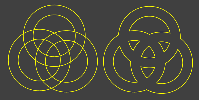

Open Offset
Creating an offset from an ‘open’ polyline will generate another open shape, offset from the original by the specified distance. Open Offset on the other hand will produce a closed shape that completely encloses the source shape.
Open offsets are particularly useful when drawing slot shapes, by drawing the center line of the slot then using the Open Offset operation. Another typical use is for drawing tracks to be used in PCB milling.
The image on the left shows the result of the Open Offset command used on an open polyline. Note that the closed polyline can loop back upon itself. On the right hand image, this open offset has been modified by using the Break at intersections operation, then the unwanted inner segments deleted.
