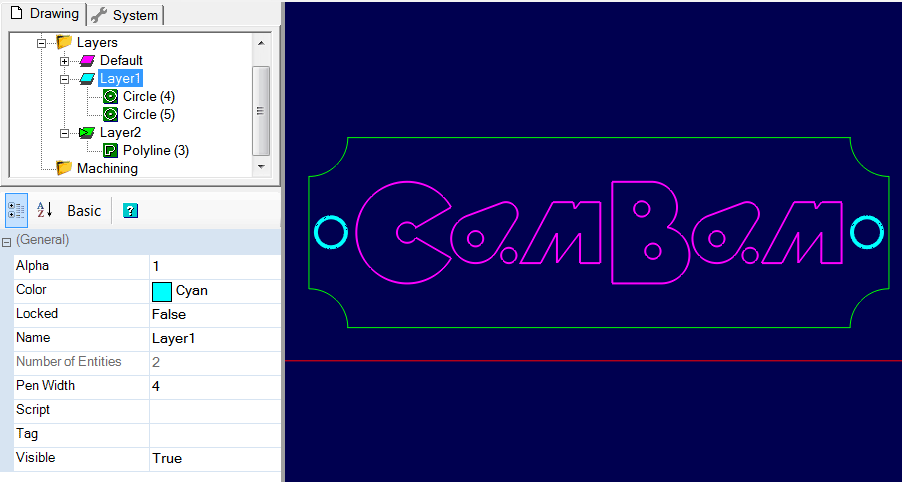

New from template
This will create a new drawing, based on an existing CamBam (.cb) file.
Template drawings are typically saved into the templates sub folder of the CamBam system folder. Use the Tools - Browse system folder menu to help find the templates location.
An example template drawing: nameplate.cb, is provided. This template allows the creation of a nameplate with raised lettering, commonly used for locomotive name plates. This template contains all the drawing objects and machining operations required. The default text can be quickly changed by double clicking the text object in the drawing view.
Changes made to a drawing based on a template will not affect the template file. To modify the template file, it will need to be opened from the template folder using File - Open.

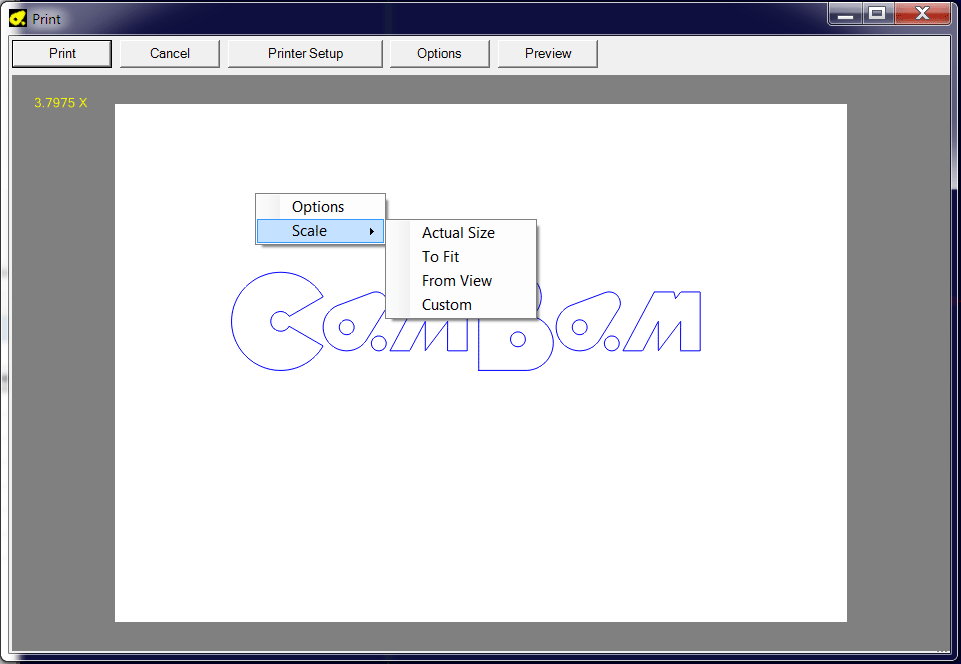

The print dialog window allows you to position the drawing on the sheet, change its zoom factor with the mouse or with a pop-up menu, and access printer settings and other options.
Pan and zoom: The zoom and pan functions by mouse work in the preview window in the same way as in the drawing area (see here) so that the area of interest can be positioned in the page; Alt + double-click in this preview window centers the drawing on the sheet.
At the top left, the zoom factor is displayed in yellow.
The zoom can be changed by turning the mouse wheel or using the Scale popup menu. You can use the Custom option to precisely set the desired zoom factor.

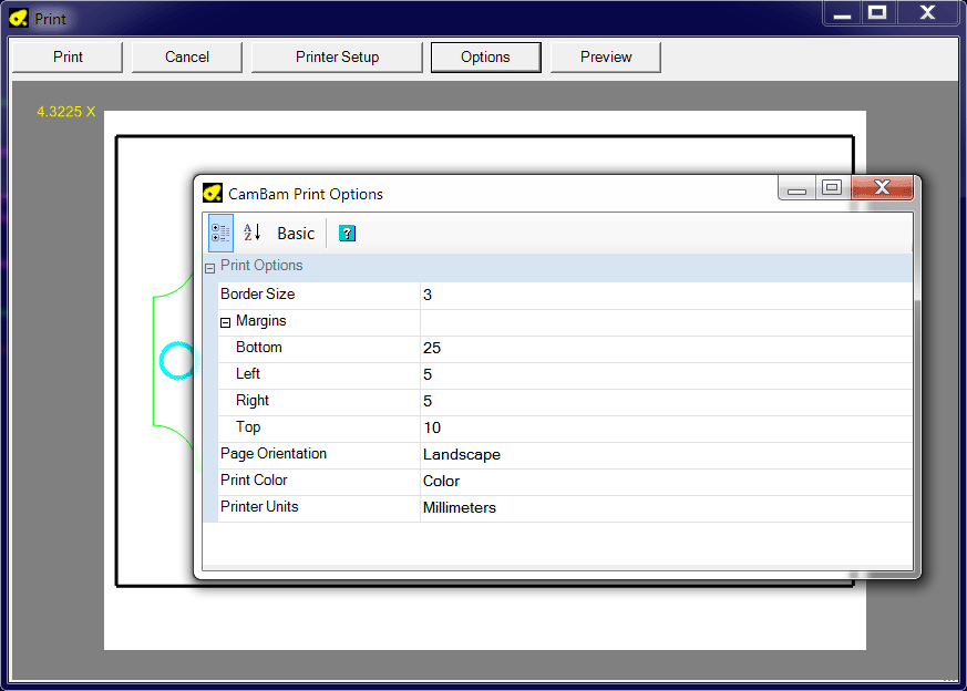

Options button: The context menu or the options button allows you to view the print options; these same options are also available in the general options of the program via the Tools / Options menu or via the Configuration folder of the system tab.
: Color, Monochrome (gray scale), or Black & White.
: If 0, the border display is disabled ; the values given in
: portrait (vertical) or landscape (horizontal)
