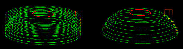

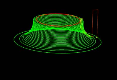

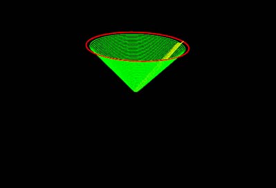

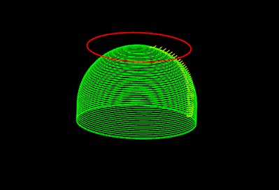

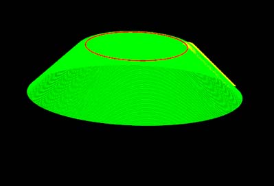

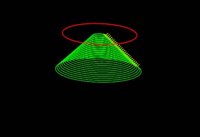

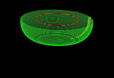

Below are some examples of various combinations of side profile methods, value signs and profile inside/outside settings.
These images were created from the side profiles.cb sample file.

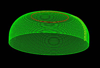

	![]() Method=CovexRadius, Value=+Ve, Profile=Outside  |
    ![]() Method=CovexRadius, Value=-Ve, Profile=Outside  |

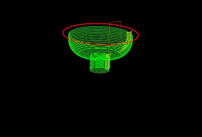

    ![]() Method=CovexRadius, Value=+Ve, Profile=Inside  |
    ![]() Method=CovexRadius, Value=-Ve, Profile=Inside  |

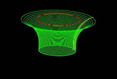

    ![]() Method=ConcaveRadius, Value=+Ve, Profile=Outside  |
    ![]() Method=ConcaveRadius, Value=-Ve, Profile=Outside  |

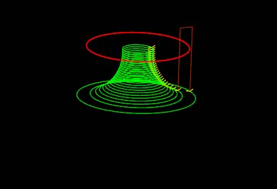

    ![]() Method=ConcaveRadius, Value=+Ve, Profile=Inside  |
    ![]() Method=ConcaveRadius, Value=-Ve, Profile=Inside  |

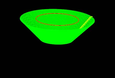

    ![]() Method=Slope, Value=+Ve, Profile=Outside  |
    ![]() Method=Slope, Value=-Ve, Profile=Outside  |
    ![]() Method=Slope, Value=+Ve, Profile=Inside  |
    ![]() Method=Slope, Value=-Ve, Profile=Inside  |
