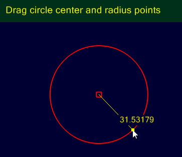

Circle
The circles are drawn with the mouse, making a left click to place the center, then after releasing the left button, moving the mouse to define the radius followed by a new click of the left button to finish.
New 1.0
A double click on a circle enter in edit mode and thus to see and move the center; click / move the center point to move it ; click / move around the circle to change its diameter.
Click the middle mouse button (wheel) or hit Enter to confirm, or Esc to cancel.

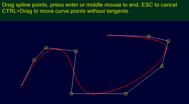

Spline
Splines (or NURBS) are curves that are defined by a series of control points and weights.
New 1.0
The splines are drawn with the mouse, making a left click to place the points of inflection.
A double click on a spline enter in edit mode and thus to see and move the control points that constitute it, as well as the points that make it possible to modify the curvature locally.
Pressing the Ctrl key while moving a control point (red circle) temporarily breaks the link with its curvature control points (yellow squares)

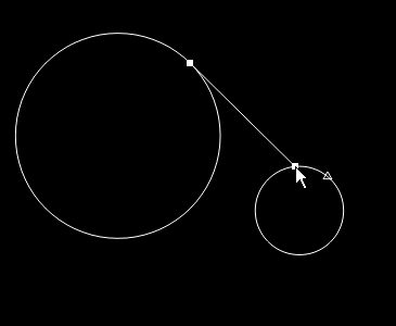

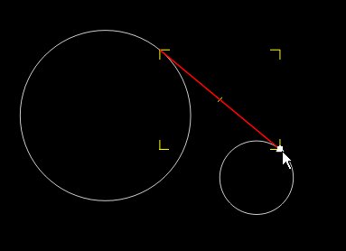

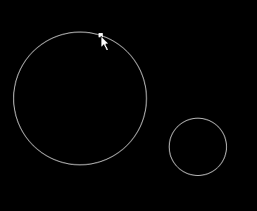

Tangent
Draws a line between points of tangency of circles or arcs (or arcs contained in a polyline)
After choosing the Tangent function, move the mouse over the first circle / arc; the end of the line will follow and stick to the curve ; click the left mouse button to fix that first point (which will “slide” along the curve depending on the orientation you give to the line)
Then move the mouse cursor on the second circle / arc; a triangle will appear at the nearest point of tangency. This triangle will change places depending on the position of the mouse.
Hook the end of the line on the triangle, then click on the left button to finish.
Note: It may be easier to “feel” the magnetization to the curve/triangle if you disable grid snapping

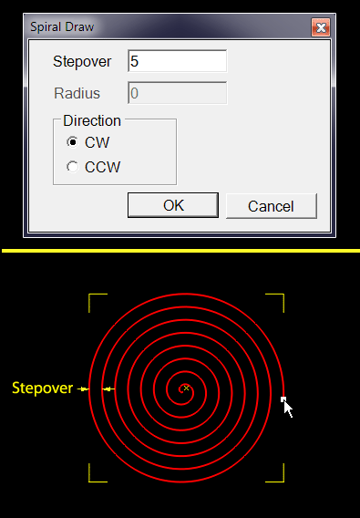

Flat Spiral
Draws a flat spiral.
The
The
After filling in these two informations, draw the spiral starting at the center and then defining the radius (as if to draw a circle)

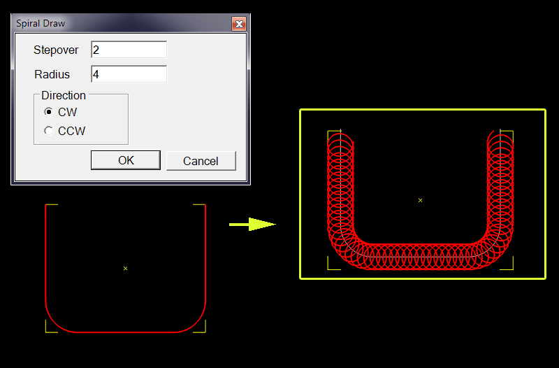

Spiral Path
Draws a spiral along a path.
First, select a shape that will serve as path, then choose the Spiral Path command from the menu.
The same window as for a flat spiral will open. It allows to choose the

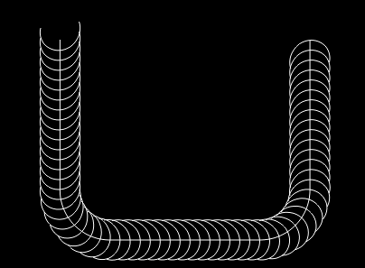

Trochoidal Path
Same principle as above, but this time it is a succession of arcs that follow the path, and not a spiral.
Combined with an engraving operation, this path allows you to quickly remove material with less stress for the tools.

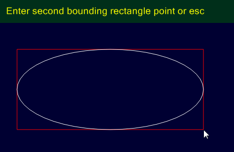

Ellipse
Allows drawing ellipses by drawing a bounding rectangle with the mouse.
The ellipse once drawn becomes a polyline, consisting of arcs and lines.
