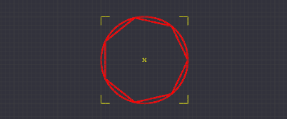

The following example draws an N-sided shape of a given radius.
# variable that define the shape...
n = 7
radius = 10
# create a polyline object...
poly = Polyline()
poly.Closed = True
for i in range(0,n):
th = i*2*Math.PI/n
poly.Add( radius * Math.Cos(th), radius * Math.Sin(th), 0)
# add the polyline to the list of drawing objects...
this.Entities.Add(poly)
# multiple drawing objects can be added...
this.Entities.Add(Circle(0,0,radius))
Resulting in this…

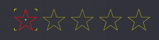

The following example makes 4 copies of a source object with each copy offset 18mm along the X axis.
This is much like using the Transform - Array Copy function with the benefit that any changes to the source object will be automatically reflected in the copies the next time the script is run by pressing F5.
# find drawing object with ID=7
ent = doc.FindPrimitive(7)
for i in range(1,5):
clone = ent.Clone()
clone.Transform.Translate(i*18,0,0)
this.Entities.Add(clone)

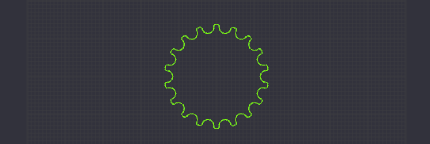

this.Entities.Add(HTD5_18.getFrontView())
The import Pulleys line instructs Python to search for a module called ‘Pulleys’.
Python will look in a search path including the current drawing’s folder and the CamBam system \ scripts folder.
There is a script in the CamBam system\script folder called Pulleys.py so that module is found and imported. CamBam also provides the following modules: Pulleys.py, StepperMotors.py and Bearings.py. The C-BEAM-Belt-Drive.cb sample file makes use of these modules to generate drawing objects.
