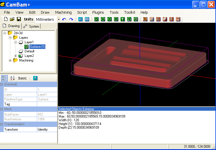

Get object extremas
Shows the extrema points and dimensions of the selected drawing objects.
Min: minimum coordinates of the object in X, Y and Z are separated by a comma.
Example: X=-60, Y=-50.000…, Z=0
Max: maximum coordinates of the object in X, Y and Z are separated by a comma.
Example: X=60, Y=50.000…, Z=15.000…
Width, Height, Depth Maximum dimensions of the object in drawing units.

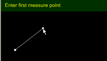

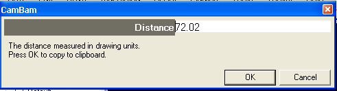

- Measure (M shortcut key) Allows you to draw a line to make a measurement between two points. The measurement result is displayed in a new window.

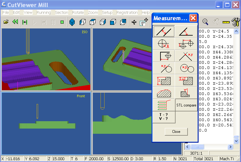

Simulate with CutViewer
Starts the third-party software CutViewer Mill, to provide a 3D machining simulation from the Gcode file produced. To avoid having to provide CutViewer parameters manually, you must use a post processor designed to work with this software. (E.g. Mach3-CV for milling, Mach3-Turn-CV for turning). You must also define a stock object in the machining or Part objects.
